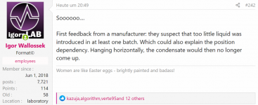

Today Igor weighs in by sharing a note from a board partner. It is reported that the undisclosed OEM suspects at least one faulty batch of Radeon 7900 series might have left the factory. The possible issue being described is insufficient coolant added to the vapor chamber.
Possible explanation of Radeon 7900 thermal problem, Source: Igor’sLAB
Igor does not want to spoil the der8auer’s new findings, so what is important is that the YouTuber is to share a new video tomorrow which should provide us more information.
