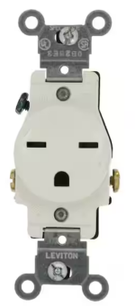

Use an adapter for the dryer plug?
There is a standard for 240V outlets, just not common in homes. A dryer outlet adapter would work though, but if you were running a new dedicated circuit, you would probably get something like this
The 15A version looks like this
The slightly beefier 20A
For sure. I forgot about those, we have some at one of our offices and I remember asking an electrician way back about them because ours were also color coded unlike the other standard plugs in the office.

you can convert a standard outlet to 220/240 single phase. Which would make sense since you only need 8 amps or so to drive 2000 watts.
You can convert a line to 220 single phase. It means ~every~ outlet and/or light fixture on that line is going to get converted as well. It's typical for US households to run all the outlets in a room, or even a group or rooms, on a single line. Very rarely do you see just a single outlet on a breaker unless it's something like an electric dryer or electric stove.
And, while technically it will work fine just swapping the neutral wire over to another hot leg for 220V on a double pole breaker, it's technically against code - as per code, 220V lines are supposed to be colored black and red (both lines hot for 220V), where as 110V are conventionally black/white (hot/neutral). So it would work but it isn't up to code, if that's something that matters to you.
You aren't wrong, just clarifying before someone runs out trying to change one outlet in their home office by just swapping the neutral wire, only to blow a bunch of stuff up.
