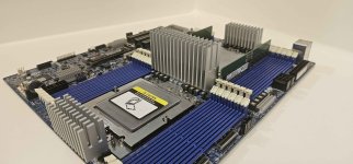

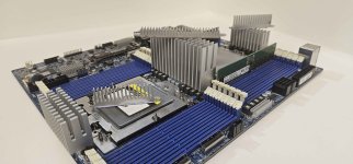

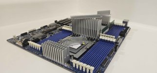

I really dislike how server boards have such tiny VRM heatsinks. However, I happened to find some upgraded heatsinks for this dual SP5 board I have so I installed them. They're massive compared to the stock ones. Hopefully they'll keep those VRM temps in check so I can run full throttle on the CPUs without throttling issues.
Just waiting on a few more things to come before I get this bad boy going.
