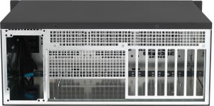

The current plan is for them to be built into a Sliger CX4150a 4U case:
Some holes will be cut in the back to allow the watercooling tubes to exit.
These will be connected using 3/4" OD, 1/2" ID soft tubing and Koolance's QD4 QDC's to allow for diconnecting reconnecting, and future upgrades, etc:

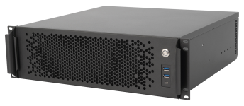

The game system will be all new parts. When I first started planning this build it was going to keep the 4090, and get a new consumer motherboard, CPU and RAM, but at this point, the 5xxx series is right around the corner, and the 4090 just isn't keeping up with S.T.A.L.K.E.R 2 so I guess I will just go with a new GPU as well.
GPU Blocks usually have their ports raised up above the video card, which means a 4U case is probably not going to cut it. I may wind up going with one of Silverstone's 5U or 6U cases just to fit the GPU, but their pricing seems rather excessive for what you get. I am continuing to do research on what case to use here, and I am going to need to get some measurements to finalize my determination on just how tall of a case I need, or if I cam maybe use some sort of adapter to mount the GPU on its side.
Just as with the Workstation build however, it will be connected using 3/4" OD, 1/2" ID tubing running out to the MORA radiators on the outside, and will have Koolance QD4 QDC's. This system will have a water block on both the CPU and the GPU

Also, before getting tot eh setbacks, I have ordered the case I am going to use for the workstation.
Instead of the 4U Sliger CX4150a I mentioned in my plans, I decided to step it up a couple of sizes to the larger 4U Sliger CX4200a, entirely because upon reading the detailed specs, my existing Asus TRX40 ROG Zenith II Extreme Alpha is slightly too wide for the smaller model.
They look almost identical, but this one is not only deeper, but fits slightly larger motherboards.
For the gaming part of this build (which will come later, after I am done with the first half of the loop and have moved the workstation over to the rack, I am likely going to use the 3U Sliger CX3171a. It is a 3U variant of the same case, but this particular variant comes with a PCIe flexible riser and the option to install a GPU sideways.
Right now their website says it comes with a Gen4 riser, but I have been in touch with their sales, and they have told me a Gen5 riser will be available in a couple of days.
This overcomes the height limitation when installing a GPU. The 3U case is just barely tall enough to be able to insert a full height PCIe card, but most GPU's have coolers that are taller than the board, and are thus impossible to install in a 3U case like this. Some GPU's would fit in the straight up orientation in the 4U case, but most water blocks have the inlet and outlet ports stick up on top, making them even taller, and not even allowing them to fit in the 4U case. Since the 3U is the only variant they sell with the sideways GPU mount, that is the one I am going to have to get. It also winds up saving me 1U of rack space (not that I am out of rack space yet, but, you never know what the future holds)
I briefly considered using the 3U with the horizontal GPU mount for the workstation as well to save an additional "U", but then I realized that this takes up almost all of the PCIe slot space, so I wouldn't be able to use my PCIe slots, and I stick a bunch of stuff in those, so that was not an option.
The Sliger cases come in a series of festive colors if you are the festive type. I'm not really festive, so I ordered black for the workstation. I'll probably go with black for the game machine too, when the time comes.
