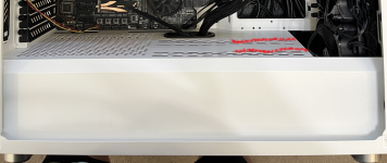

No worries. I do agree with you and Steve. I'm looking into buying metal cutting shears. Spending $20 on that isn't a problem and I've got the strength to do it. The air vent holes could actually work to my advantage.
Yea my thing is you will ruin that clean look unless you go at it with a grinder and some metal high grit sandpaper then repaint it. Sounds like a PITA though at that point might as well go custom loop then why buy the card with the AIO.
Yeah, I'd say we've found the next design step that case manufacturers need to take. For a moment I thought I'd seen some on the Lian Li page where they showed the shroud is removed. Nope. Check this out straight off the site. Oh well. For now I'm going to leave it but I'm pretty sure I'm going to mod the shroud so I can flip it but I'm in no hurry.
I think what I'll try to do is measure the height of the shroud and cut back that much and just fold it down to give the hoses enough clearance for a gentle bend. I've got a hunch that could work. I probably don't even need that much. You can get a good guess of the shroud height from that pic you drew the red lines on. I only need about 3-5 inches to get the clearance I need.
I just looked and the orientation of those vent holes, after the rad is flipped, are actually almost exactly parallel to the hose ports on the rad. It could actually work.

The way the rad is mounted is just fine, the big no no is having the block above the rad, in your situation you have most of the rad and the tubes above the card so you are fine. I'll add a Jat vid exlaining how a lot of people misinterpret Steve's vid.
