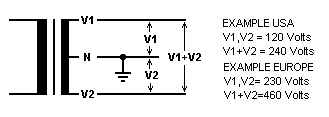

Kinda surprised you didn’t leave the 230 outlet at 230 and run the PSUs off the higher voltage for that smidge better efficiency

Earlier in this thread I converted the old NEMA 14-30 dryer outlet in my "server room" to two NEMA 5-20 receptacles on an MWBC circuit. This gave me a lot more power to the server room, and let me plug each of my two APC SMT1500RM2U UPS:es into their own dedicated circuit.

Maybe I should take a quick break here and explain how U.S. power delivery works.
Most consumer devices in the U.S. operate at 120v. (sometimes referred to as 110v on older devices) There is an acceptable range of voltages at the wall. I can't remember what they are, but in my house all the outlets are usually at 122-123v.
Typical residential power delivery in the U.S also supports 240v power. This is usually only used for large appliances (stoves/ovens/ranges/clothes dryers/heat pumps/AC units, etc.) The way this is accomplished is through split phase power delivery.
There are two 120v AC live lines that enter the home. For most regular outlets you just use one or the other and wire them to neutral, trying to balance the load best you can between the two.
The two lines are polar opposites, meaning that while at any given time, the difference between either of them to neutral is 120v, but if you wire from one live line to the other live line you get 240v
And that's how a 240v circuit is wired in residential/office power in the U.S.
Industrial power delivery can be a little bit different, and is often provided in 3-phase. If you take any two of the phases in 3-phase power delivery, and wire a circuit between them, you get 208v. So that's where the 208v comes from.
So, while most of our European friends have 230v live->neutral circuits, when we have power in the 200-240v range in the U.S. in residential it is usually 120v->120v split phase (no neutral) producing 240v or 208v with two out of 3 phases from a 3 phase system.
So, I was hoping to find a UPS that passes through both 120v and 240v, and that was just not happening.
