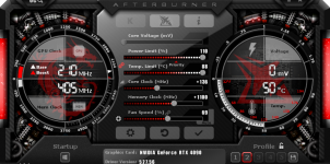

Here's the settings that I was using that we're mostly stable but depending on the game would crash. Witcher 3 got really finicky during various cutscenes. Metro Exodus was a bit nicer but would occasionally crash out of the blue. Timespy ran fine.
